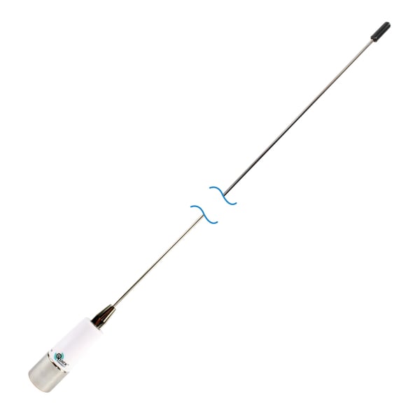

This is what I'd get:
Mount it on top of your tower. Will be barely visible.
Looks like they make those in 3, 4, and 8 ft antennas. If they had a 1ft that would be awesome for nearshore and then I could swap out for a 3 or 4 ft antenna when needed and it would extend above the tower.
