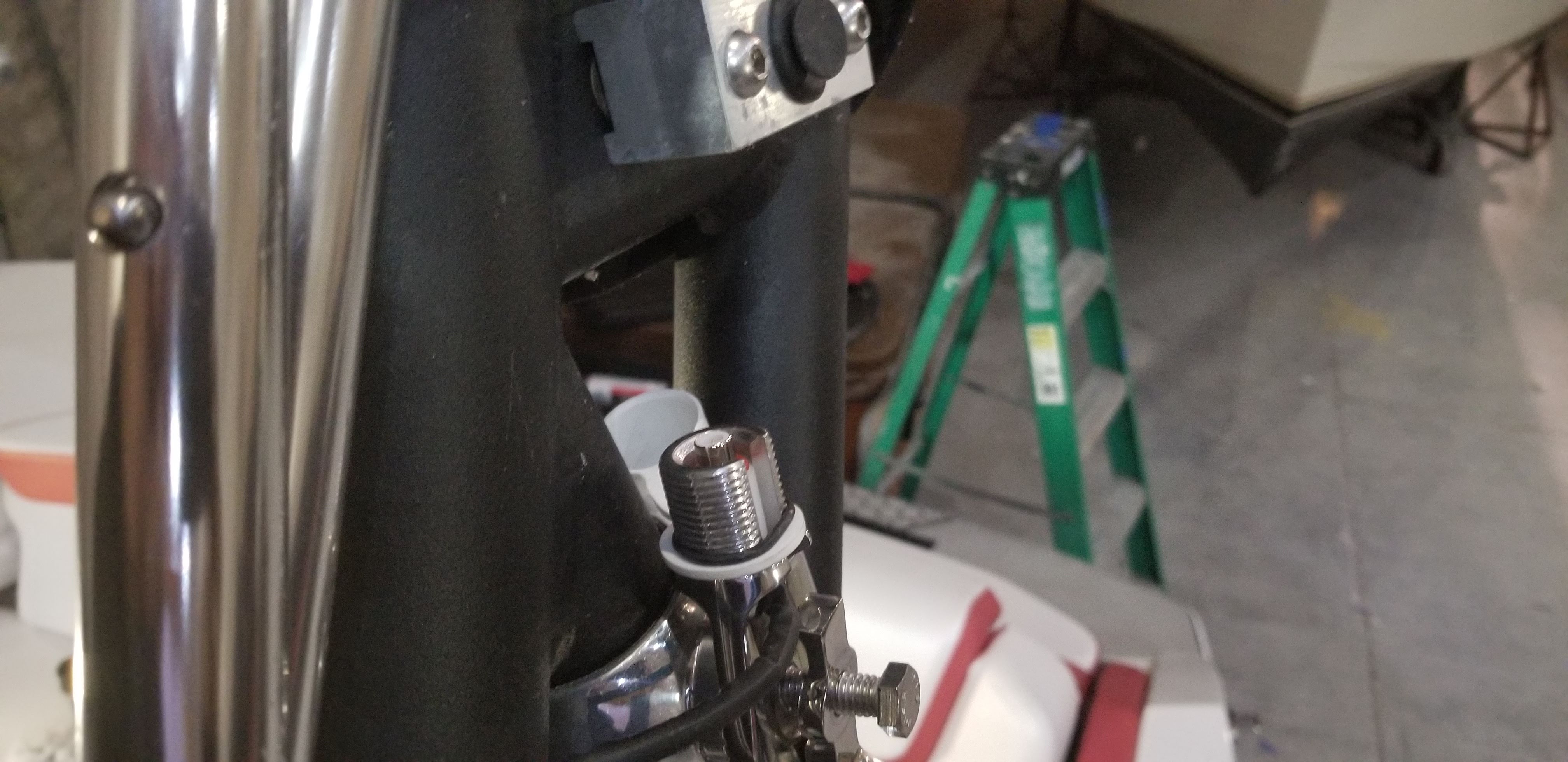

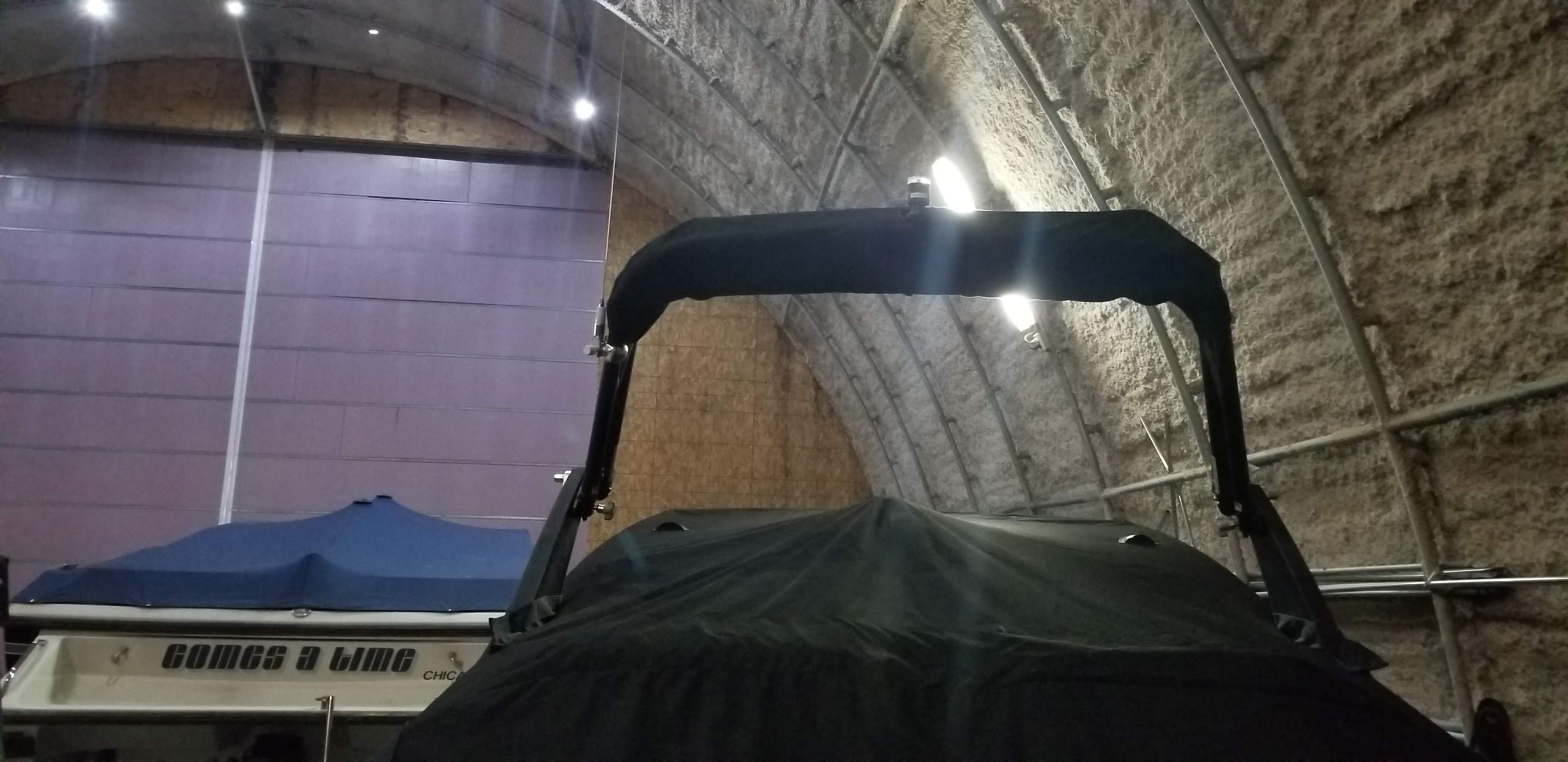

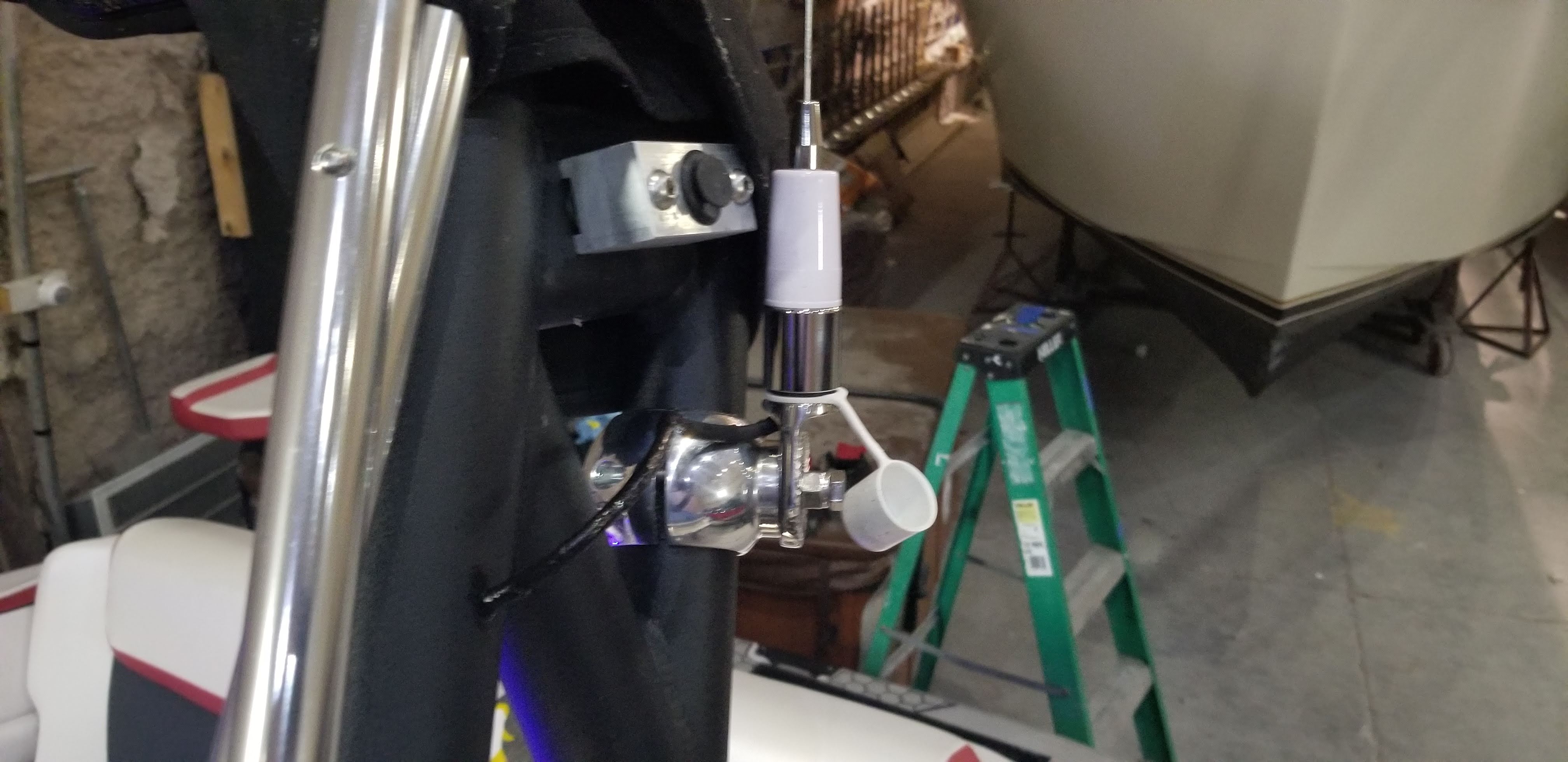

I like it! Do you have a link to that mount? It looks like it just clamps to the tower, no drilling? I saw Shakespeare makes a clamp mount but didn't look like it was big enough for the diameter of the tower (only 1-1.5"). I can't tell on that Scarab for sure but the tube on my 212X is over 2".I mounted a Shakespear quick connect antenna on my tower:
This is what it looks like (sorry, these are the best I have):
As others have said, I can remove the antenna completely, or fold it down if I just didn't like the look (haven't bothered). Of course swapping to a longer antenna would be a snap.
I put this on in anticipation of going to Bimini last summer, which never happened, but I've never had the opportunity to these the full range.
Alot ot people install a 6-ckt. Blue Sea pos/neg fuse panel at the helm. Feed it from the battery with the correct sized wiring for the run of 100a and circuit breaker. Something like this. ST Blade Fuse Block - 6 Circuits with Negative Bus and Cover - Blue Sea SystemsWhat about power - do you all run from the radio at the helm back to the battery or tap onto something already at the helm?
Yep, I shamelessly stole @kthrash 's idea of using a tower speaker mount and attaching my antenna to it. Here is part of the thread that better explains my install.I like it! Do you have a link to that mount? It looks like it just clamps to the tower, no drilling? I saw Shakespeare makes a clamp mount but didn't look like it was big enough for the diameter of the tower (only 1-1.5"). I can't tell on that Scarab for sure but the tube on my 212X is over 2".
I didn't want to risk drawing too much power through the OEM circuit breakers, so I ran a line from a switched power source (ie media system) to a relay that hooked directly to the battery (via fuse). I then connected a fuse box (similar to what @zipper has) to that line to run my accessories. May have been overkill but I'm comfortable that the system will not over tax the OEM circuits and, of course, still be protected.What about power - do you all run from the radio at the helm back to the battery or tap onto something already at the helm?
Looks good! I think I am going to try the same thing. Which Shakespeare QC mount did you use? The plate or the clamp one? Not sure if it matters.Yep, I shamelessly stole @kthrash 's idea of using a tower speaker mount and attaching my antenna to it. Here is part of the thread that better explains my install.
It was this one. I just removed the base and put the bolt through hole.Looks good! I think I am going to try the same thing. Which Shakespeare QC mount did you use? The plate or the clamp one? Not sure if it matters.
