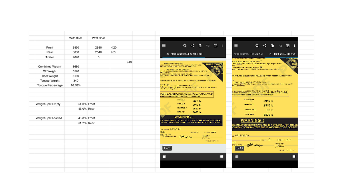

3,400 is heavy for an SX190. My AR190, with a full tank of fuel, a tower, and all our stuff for a day on the lake scaled at 3,160. The tower alone is around 100lbs (took 2 guys to get mine off, but wasn't absurdly heavy), I'm guessing the brackets and hardware are another 40-50.
Here's my scale tickets and calculations.
Tongue weight was 340lbs on mine. So 2,820 on the tires, or 1,410 per tire. Assuming a 1,710 limit for each that's ~20% overhead. I wouldn't call that "cheaping out" myself.
With that said, the move to radials was huge for me. They ran smoother, and cooler than my bias plies. I also lost two radials in a single day a couple weeks ago, soooo.......My opinion is any well maintained tire is best, regardless of radial vs bias ply.
