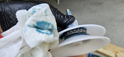

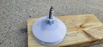

When you jack a wheel off the ground you should be able to feel some play in the bearing, just a small clunk.I think I found my issue now that I have a temp gun. The calipers on both sides are within a few degrees of each other. That tells me it's not braking related. The front of the hubs are definitely warmer. It was cooler out today so it was only 120*ish on the hot side. So it's not like it's boiling over or anything, but I also haven't been on any really long drives. Storage is 11 miles and the ramp is 7 miles away. I have new bearings so I'll replace that side and check again. The wheel spins freely so I don't feel like I tightened the castle nut too tight, but it's a very slight chance it's a hair too tight creating the extra heat. I'll check it before I pull everything apart, but since I have new bearings I might as well just change them. View attachment 237989View attachment 237990View attachment 237991View attachment 237992View attachment 237993View attachment 237994
Yup, it does now an ever so small clunk, but it's there. I tried backing off the nut to the next hole but it was way too loose. We'll see how it does. Dunno why I didn't buy one of these bearing tools before. I have so many trailers and hate hand packing bearings. I will say the timken bearings look to be more robust. I still didn't really see a reason for the added heat. If I still have the differential I'll back off the nut to the next hole. I just feel that's far too loose.When you jack a wheel off the ground you should be able to feel some play in the bearing, just a small clunk.
I feel like I'll be chasing my tail trying to get these any closer. At this point I feel it's just the differential in the brakes. I'd say the difference now is between the brakes according to caliper temps. Almost exactly off the same temps and within an acceptable range of difference.When you jack a wheel off the ground you should be able to feel some play in the bearing, just a small clunk.
I've been meaning to get one of those. I need to do my MIL's brake fluid and was going to pick one up. I have a mighty vac hand pump and it does ok.Right on sounds like you’re making progress!
I will say, since I use that power bleeder on my trailer brakes, I’ve never seen the temperatures more consistent between sides and the differential between the non-breaking axles and the breaking axles is roughly 10° on each side best I’ve seen so far, and breaking performance on the trailer seems to be the best it’s ever been.
I tried using a vacuum bleeder on the boat trailer and didn’t have very good success, the power bleeder sure seems to have gotten the braking system working the best it has and for whatever reason the braking hub temps are now almost identical on both sides. The non braking hubs were always close, but the right rear braking hub was always hotter than the left rear by 15-25°, now they’re within 2-3°, the right rear hub temps have dropped.I've been meaning to get one of those. I need to do my MIL's brake fluid and was going to pick one up. I have a mighty vac hand pump and it does ok.
