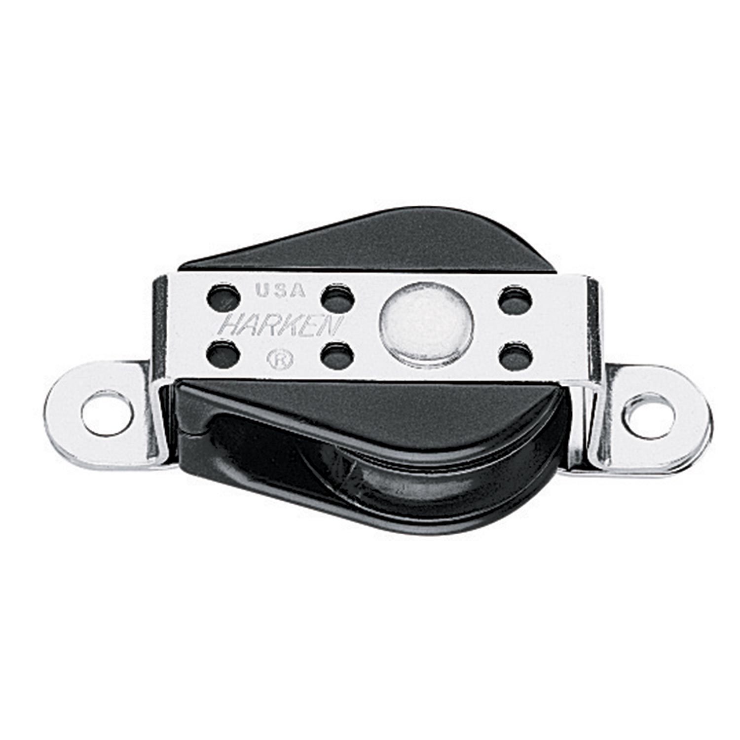

Meanwhile there is plenty to do, as the new toilet arrived yesterday. The new sheaves for halyards in the mast base are here and the windex is ready to mount. I also need to mount cheek blocks 30’ up from the base for a lazy jack system and sailpack.

Picture of a lazy jack, sail containment/flaking system. Cheek block circled and in link below.
