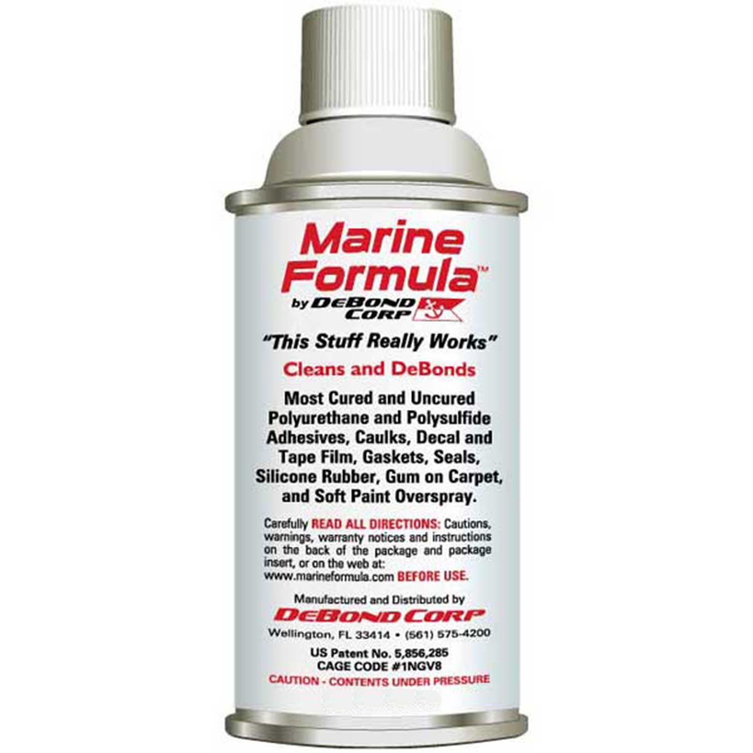

Not sure about the adhesive on Seadek, but this stuff works on 5200 and sikaflex. Been using this to restore my boats since 2018. Search Debond here... Teak Sea dek replaced with new style (completed)
Or get it cheaper here...

The brake cleaner mentioned will work too, and @HangOutdoors used that stuff @zipper pointed out, with good success, but that was relatively new SeaDek he was removing.
