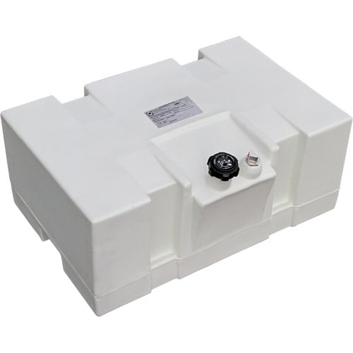

First and foremost, many thanks to @Liveto99 for his help with the Moeller 22 gallon fuel tank .
I was looking at extending my fuel range, or at least getting some extra cushion for some big lakes who’s services are a bit far in between. @Liveto99 had posted about the purchase of the Moeller 22 gallon above deck fuel tank which I believe was originally designed for the boston whaler montauk. This Moeller tank fits perfectly under the helm seat of my 210 FSH sport. The only issue is that the recess for the OEM cooler leaves the underside of the gas tank unsupported.
My friend who has many years in the marine industry suggested using a piece of closed cell concrete insulation foam as a filler piece that could be easily shaped. The foam itself is rated at 25 PSI strength, more than enough to support the tank and 132 pounds of fuel.
I bought a piece that was 1.5“ thick, cut it to fit the recess, my friend used a belt sander to make it conform to the slanted ice chest depression. He suggested a put a layer of flex seal on the foam to seal the outer layer of the foam and then it would match the deck also.
I needed to get the fuel from the on deck tank to the main tank of the boat. I bought a Summit branded 97gph fuel pump and fitted that with some double sided shut off quick disconnects to make it easy and spill free.
The pump and hoses all fit into a rubber made cereal container to keep it clean and secure. The pump transferred 12 gallons of fuel in 12 minutes. Not what the pump is rated at because that is with 3/8” fittings and my quick disconnects are 1/4”. Still, that means with 22 gallons of fuel it will take 22 minutes to transfer the fuel over. So probably a 25 minute stop to refill the main tank.. good time for a break anyway!
The OEM cooler will fit in between the Moeller tank and the transom. I may just use a door mat for the cooler to sit on to give it some extra purchase.
If y’all need any info on the parts and pieces let me know!

You could probably open the hatch but it would be a bit heavy. The tank when full would weigh around 150#.
The plan is to only fill that tank when I think I am going to need it, and then as soon as the 22 gallons will fit into the main tank I will transfer the fuel at that time.

The extra fuel tank worked great on my trip. I used it to add fuel to my boat as well as adding fuel to my friends wave runner on some long trips. The OEM ice chest fits nicely between the tank and the transom.
I just slid the fuel tank out of the way to open my hatch. that knock off yeti cooler that we bought a while ago from Amazon fits between the fuel tank on the back also. I would not transfer fuel well underway just in case of a wave or some thing getting water into your fuel tank with the hatch on the side. In a pinch you could just siphon the gas.

Everything worked fine for the week long trip to lake Powell two years ago. The empty tank is light so putting it in or off the boat is easy. The fuel pump will transfer all of the fuel in 20 minutes.

Looks like the fuel tank is $394
I can’t remember how much the fuel pump was , maybe $100. Perhaps $25 for the straps. I had the quick disconnects and the fuel line. So less than $600.
Nothing I would change. I was thinking about trying to intercept the main fill line so I could put a quick disconnect there to keep all of the fuel filling inside the boat. But I decided to stick with putting fill line into the main fill. I may put a switch to turn the fuel pump on and off, right now it’s just big alligator clamps.
