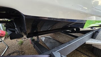

Sounds like chine walk. It would be interesting if you adding water to your center ballast would help plant the boat/pumps.
It probably would but also the top speed would probably come down. The issue probably is also due to the outer most chine is removed 16" befor the transom only on the X models. You can see in the picture that right where the geen stops the side chine stops too.
Yeah, that makes sense...
could you install some waverunner spontoons in that spot?!
Your a genius I was wanting something removable. I was thinking of molding something up. I need to take a 255 fhs for a spin. They have a standard hull.
